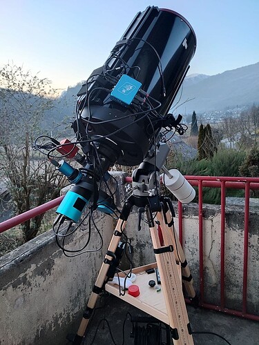

Hello, from France, I am using the WD-20 with a Berlebach uni18 I initially bougth for my AM5. The compatibility is immediate bewten WD-20 and Zwo am5 base.I have just attach the berlebach am5 adaptor on the wd-20. As I am using a RC10 (18kg with all camera etc…) I was not confident to use the carbon zwoTC40 tripod that is too ligth.

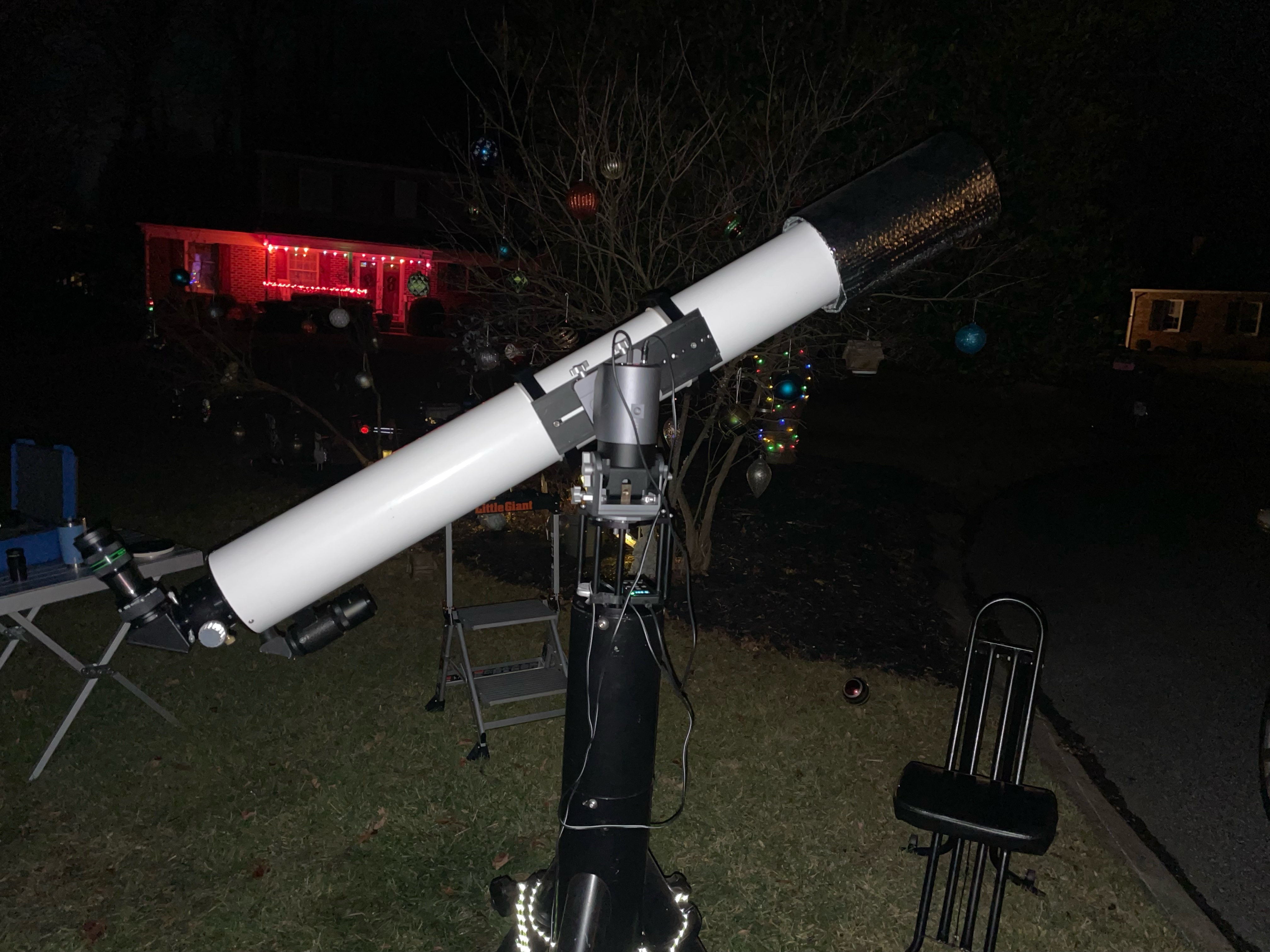

here is my current setup - still ironing out the wrinkles
I’m jealous of your actual observatory. My scope is regulated to sitting on grass until I can convince the wife to let me build something more…permanent.

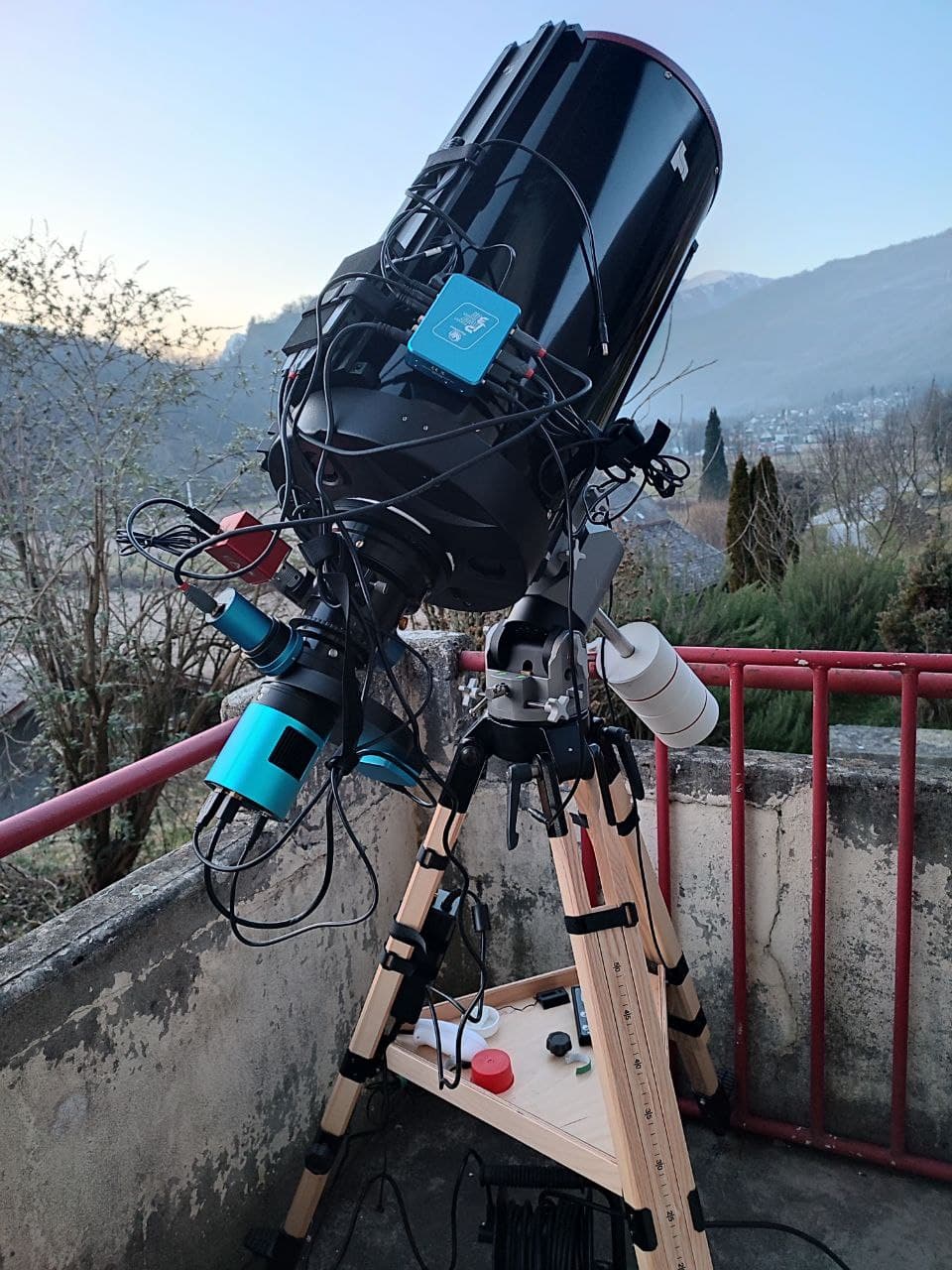

This my setup figuring the Berlebach Uni18 tripod with AM5 plate. The Wd-20 is supporting the RC10 (18,5kg with all equipements).
All run fine. I am still wondering if I need the counterweigth or not (9kg ctually) . Iput them to balance everything because when I put the tube on the Wd-20 it has a tendancy to flip.
