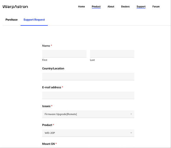

How to Schedule Your Upgrade
  1. Visit our Support Page: https://www.warpastron.com/index.php/contactus/
  2. Submit a [Support Request]ticket with your mount’s serial number (SN)
  3. Our support team will contact you to arrange the RDP session and provide the necessary connection information

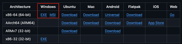

Requirements for RDP Session
  • A Windows PC and connected to the mount
  • Install RustDesk Client (free to use; we’ll provide server address): Download Link
