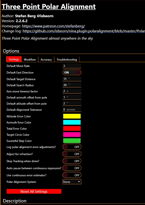

I just received my WD-20P a week ago and I’ve been working towards getting everything set up. All of the mechanical connections etc. have been done with little or no problem. Talking to it with Stellarium and NINA are seemingly working just fine, too. Next steps are polar alignment and then getting guiding working - now I’m having an issue!

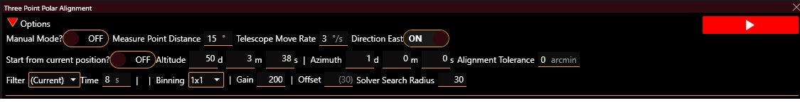

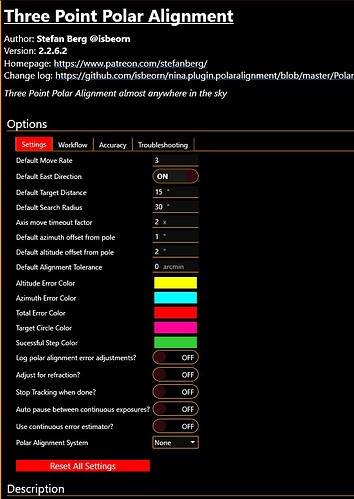

I haven’t really gotten to trying to tune PHD2, yet, as my issue is with getting my polar alignment done accurately with Three Point Polar Alignment (TPPA) in NINA, hence this post. I’ve attached 2 screen shots of the settings that may be where my problem is. If there are more settings that might be of interest, pleas let me know and I will post those.

I have tried a couple of things since I first posted. Limited nights to try things, though have kept progress down, but the aligning seems to have improved. Things that I have done on the TPPA Options page were to turn Default East Direction to Off, and changed the Polar Alignment System from “None” to one of the options (right now I don’t recall which). As the posted settings were seemingly working OK with my EQ6R, I’m not sure of the difference but things are definitely improved.
