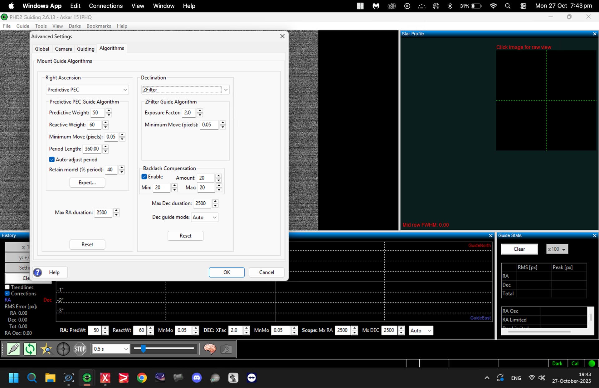

Hey Buzz, I recently purchased a WD-20. There is an Askar 151PHQ scope and Eagle5s mounted on it. Also along for the ride is an OGA (174mm) and 2600mcp and a Senso Sesto 2 all weighing 15.7kg. I am about to implement your recommendations for setup on PHD2. Does this look right? Can’t seem to find where the 75/75 aggression goes. Can you help, please?
Cheers, Peter
