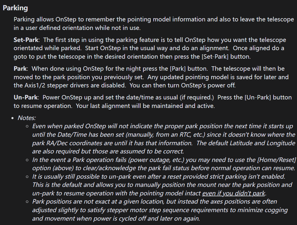

For park feature, it’s critical to set/update Time/Date first once mount powering on. To park and unpark the mount, the mount need time to be updated, as park feature rely on the coordinates systems.
Default park position will be same as Home position, you can customize other park positions by performing Set Park feature, this can be done via Hand controller or Set Park button on INDI panel of StellarMate.
And it’s always important to ensure mount has a correct coordinates. Mount rely on home sensor to return mount to home. This is normal operation to return mount to home before start a sequence.
If you intend to use park feature to set mount to other position rather than home position when operation ended. You need to use the Set Park to define that position first, not Park, as Park is to move the mount to the position been Set Park.
Once you have defined that customized park position then you can use Park to move the mount to that position. It’s always important to sync the time/date before doing park related features. Detail can be seen refer to OnStep wiki:
